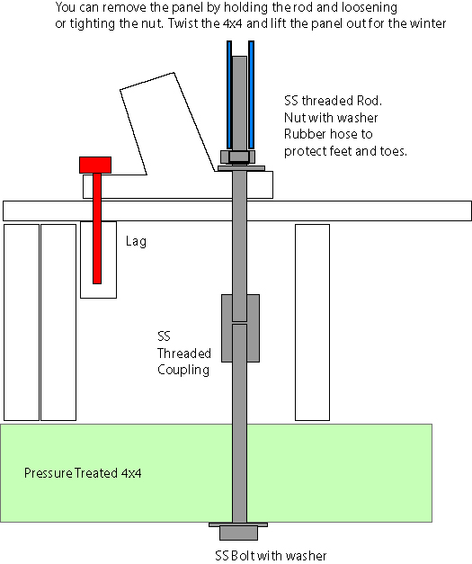

This has worked very well for us to allow easy in and out for the winter while providing a very solid grab on the wooden dock joist. (As described above)

The rocker bases look like they would solve the problem I have avoiding the hanging whips while docking. But the price just for the bases...

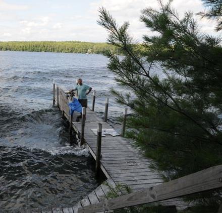

One of my tenants has actually been injured here while working on his mooring whip-equipped boat!
Yes, we have a "recent" wake problem and have to "double-up" on dock lines or put our largest boat on the mooring. Fortunately, it's mostly just weekends.
The exposure here is such that a warp-line gets snagged with any change of wind. (One line becomes "loaded", such that it is brought closer to the surface than the other line). Warp-lines work best on dinghies without rudders or propellers: our smaller boats just get pulled out of the water.
Now I have a question for a seasoned ocean sailor that relates to whips, wind, and wakes. (To simplify, leave off "spray" from the equation).
If that photographed wake was "normal wave action" from wind, what would you estimate the period and frequency to be? For reference, the dock is five-feet wide, and that is a wake from one boat.

The exposure here is such that a warp-line gets snagged with any change of wind. (One line becomes "loaded", such that it is brought closer to the surface than the other line). Warp-lines work best on dinghies without rudders or propellers: our smaller boats just get pulled out of the water.one boat.
APS: That is an Excellent point that I had not considered. SO: Think of some way you can attach a "Sentinal' to the warp to keep it low enough to avoid the interference with props, outdrives, rudders, etc NB
PS: "Chapmans" has stuff on Sentinals I think.
Old 06-01-2010, 06:30 PM   #40
NoBozo
Join Date: Jun 2008
Location: Portsmouth. RI
Posts: 2,231
Thanks: 400
As a seasoned Ocean Sailor I feel Must step foreward.
If that were my dock.... and that was Normal wave action and frequency......as I understand it.....Frequency being the time in Seconds ..from Crest to Crest....as the waves roll by...........
I would build a breakwater. NB
