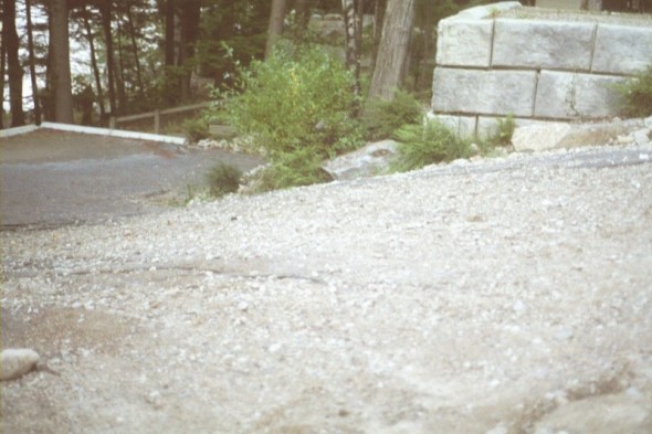

What you don't want for a driveway surface is what a neighbor's single-family residential rental unit got: some kind of thin asphalt skim.
Dry, it worked fine. Wet, tires started digging up the surface.
In only two years, nothing was left of the original asphalt except what can be seen at the dark, flat area bordered by a white curb in the 2007 photo below (left).
This driveway is a very steep driveway, and downslope from a shared steep dirt driveway that has still more issues itself. Those driveway problems are compounded by a raised shared leachfield that divides floodwaters down both driveways.
The cement parking platform blocks (right) were straight upon installation in 2005, but have shifted downslope even more since this photo was taken in 2007. Their roots covered, the two large trees adjacent have both died, dropping branches on cars parked there.
