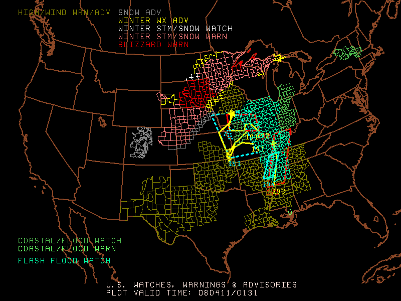

Here's the storm as depicted on the Thursday night watch & warning map. Look at how many different types of weather there are! And a few of them aren't even supposed to be where they are in mid-April. The blue and red boxes are severe thunderstorm and tornado watch boxes. Everything else is in the map legend.
