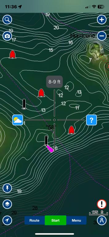

Traveling through the Six Pack yesterday afternoon heading toward the Bridge had a prop hit inside the second set of markers. Initially thought it might have been a log, but based on damage it was a rock. We were well inside the second red marker slightly to the right of center. Bizer, Navionics, Depth gauge all show safe water levels. Not so. Be careful and watch your gauge in the Six Pack, it was an expensive ride

One of the markers could have moved…thanks for the heads up! It might be a good idea to inform Marine Patrol…

The OP said his chart, GPS, and depth gauge all showed safe, so we might just be talking about the standard error of GPS calculation?
What is that these days, 6-10'?

To the OP. Were you fully on plane or semi plowing through the area? Not knowing what type of boat you have, that could be the reason you hit a rock.

28’ I/O with 3 passengers @ 15 mph so I had a deeper draft going…for sure

That’s from the Navionics app on my phone.
With water levels down, that area is more shallow than I’d expect. As soon as I made impact, I checked my depth gauge and it read 6.2’
Such a bummer. No matter how much experience, there is always something to learn on the lake

Granted, I have not been there to run a depth sounder but the chart I am looking at shows 8'.
8' becomes 7' if the water is low.
The boat might draw 3'-4'.
Another 2' for the drive gets it to 5' or 6'.
Plow the boat and you get maybe 7'?

Not entirely correct. Bizer does show the southern half of the 6-pack in blue which indicates that much of that area is six feet or less. Back in 2010, Bizer did find one four-foot rock inside the 6-pack between the two red buoys. There is a "4" on Bizer's chart. When going northwest (with Long Island on your left), I tend to stay near the middle of the channel when the lake is low.
I shall be looking into this area during Bizer's annual survey of the lake in September.
I shall withhold comments about the accuracy of Navionics' depths.

There is a rock there, no doubt, based on my prop damage. I was heading toward the Bridge, there were two boats approaching, so I was to the right of the channel, well inside the red markers. I use Navionics on my chart which shows 8-9 ft. Just after the hit, I checked my depth finder, it read 6.5. Yes water levels are below average for this time of year. IÂ’ve been through there dozens of times over many years on the lake, completely caught by surprise. My bad, I guess, but this area needs markers adjusted IMO. Just be aware, it is a hazardous area inside those channel markers

I kayaked over there with my son this morning. That rock pile is about 6 or 8 feet inside the markers. You can just make out one of the red spars over the stern of his boat.
His paddle is resting on the rock. It's maybe 3 feet under the surface at this lake level.

That's worth a call to Marine Patrol as that's a real danger. They should reposition the marker.

Thanks for confirming this again. Markers need to be moved. Channel will be a little narrower but still plenty of room.
