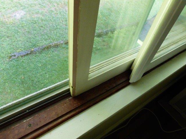

Default Photo of the window
As I said above, the window has dowels on the top and bottom that slide in a track. I can't see how to remove the window. The dowels seem to prevent the window from being lifted out of the track. Has anyone seen this type of window before?
SailinAway is offline   Reply With Quote

Old 08-30-2021, 04:47 PM   #20
billy
Posts: 87
Thanks: 192
Thanked 38 Times in 19 Posts
It looks like there are screws keeping the sill in place. Removing them may let you slide the sill out and tilt the window towards you so it can be removed?
billy is offline   Reply With Quote

Old 08-30-2021, 06:22 PM   #22
DickR
Join Date: Apr 2008
Location: Moultonborough
Posts: 750
Thanks: 4
That window looks just like two of those in our cottage, and they are quite old. I think they are Andersons. Anyway, IIRC, with one side opened onto the inner track, you lift the window frame upward and pull the bottom edge inward toward you. Be careful, as they have some weight. The other side would come out the same way, once moved toward the center a bit to free it from the side. If you wish, I could verify this, but I won't have a chance to do so until Wednesday.
The Following User Says Thank You to DickR For This Useful Post:
SailinAway (08-30-2021)
Old 08-30-2021, 08:30 PM   #23
John Mercier
Join Date: Jun 2021
Posts: 3,369
Thanks: 3
Thanked 594 Times in 490 Posts
Andersen Primed Wood Glider? Possible.
https://helpcenter.andersenwindows.c...ment-1940-1971

My company sells Andersen.
Once DickR suggested it to be an older Andersen, I just used the online library.
It is part of their customer service tools.

So, I'm able to get one side of the window out, but the other side won't come out. It appears that the window isn't quite square in the frame. The space between the top of the window and the frame above it is slightly smaller on the stuck side, hence the dowel won't clear the track on the bottom. My idea is to use a chisel or a fine dovetail saw to cut about 1/8" off the top of the window on the stuck side so the window can be lifted up to clear the sill. Could be hard because I wouldn't be able to cut past the dowel, which it turns out is metal. I could also try to lift the bottom corner with a crowbar.
The plastic sill can't be removed without removing the windows; it's held in by the dowels in both windows. I tested another window and it came out easily. Maybe the humidity has swollen the frame and casing of the stuck window.
One way or another, the window has to come out so the panes can be replaced.

Default Problem solved
I used a small saw and a chisel to cut a little notch in the sill, 3/8" wide and 1/4" deep. That was enough to allow the pin to clear the track at the bottom. It took all of 5 minutes. The sill is made of a wood-like material that was easily shaped. The window is now outside and I rewashed the window frame with vinegar as per someone's advice here. Thanks to all for your help!
