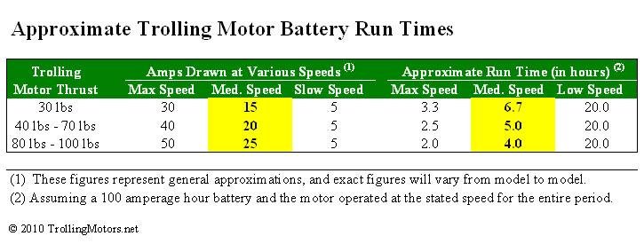

Anyone have an idea of the rough amount of time these things run on a single charge?

Scratch that--just found this. I think 75AH with a smaller motor would be fine--at least 2-3 hours and more likely longer. I'll look at the specs when I get the motor.Name:  motor_battery_life_0908bae9-ada2-4123-9183-333950d9fc54_1024x1024.jpeg

The 90AH should give L'il Buddy around 2-3 hours at max, which is plenty (of actual run time). He can row, otherwise!
