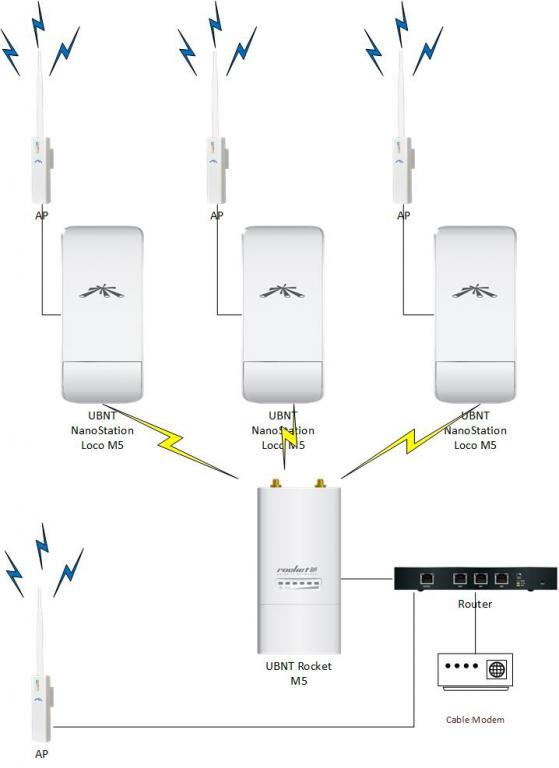

I've used Ubuquiti (carrier grade but cheap ~$80) gear in the past to handle the point to point links (using a Rocket connected to the cable modem and some Nano's as the end points) and then connect a Unifi wireless access point. It's pretty straightforward to someone who knows networking. I'm not really in the business, but if you don't hear from anyone I can help someone from your association.

The Ubiquiti stuff I mentioned is all outdoor rated and provide separate wireless links (doesn't use the repeaters, which decreases end user speeds).
Here's a quick sketch. The links from the Rocket M5 to the NanoStations can reach up to 16 miles in clear space, less through trees. And each component costs ~$85. Think of the Rocket and Nanostation combo as a long ethernet wire, and at the end of the wire is the access point. You can have a bunch of these connections and you can add them over time.
I hope this helps.
I hope this helps.
It does, do you have a link to those by any chance, I will take a look myself but was just wondering if you had a trustworthy source to use for them
