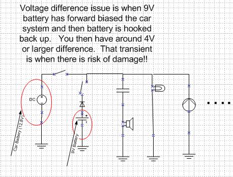

As for any of the work arounds here, etc. that I keep reading... I recomend none of them... No offense guys... but the link for using a secondary battery in parallel??? that is asking for a problem, and with the electronics in the cars today you are asking for an even bigger problem.... As for the 9V solution... I would like to understand more about this? but quite frankly I think your fooling yourself thinking that a 9V battern is keep your memory alive....
The problem with this type of setup is you have numerous parts with regulation and blocking. 9V is several diode drops below 12V. In most cases we assume voltage dropping to maybe the 9.8V range.
The reason why people think it works is we overbuild our designs. Period. However all our devices have given current density limitations through subtrate contacts to ground. Current actually flows from - to + as some of you probably recall.
Take 3V across a low ohmic contact and guess what happens during that transient? Look at the simple equation for capacitor current and doing this is ugly. A parasitic BJT in a power MOSFET only needs 0.7V to turn on and destroy itselt.
If you over power the contacts you can get electromigration. If in a radio, this can cause issues that may not be destructive but could be subtle. Phase locked loops can get out of whack, reception range effected, you name it. You may not think you did damage but you did.
In design we see the field returns and get to understand failure modes. Nothing is fool-proof as hard as we try. We never do biased reliability testing at 9V for auto applications which should tell you something.
Many technicians will claim I am full of it because they "get away with it". However as a designer of high power applications with automotive and appliance products this is terrible practice. We have to put stuff in our designs just so that when people do bad things to parts we can demonstrate why the failure was user related and not our part. This is also why warranty claims get denied.
In todays systems we have a lot of detection systems to look for shorts and undervoltage protection because it's such an issue. Most of the issues are from the assembly process and when maintenance is done on the car.

jrc, mostly likely there's a clue to your question everytime you start your car.
Turn on ignition and radio but don't start car. Now start the car. Did radio stay on? Hmm, wonder why that would be
For the starting application the system voltage is uniform. For damage to occur on devices you need the relative voltages to be different.
Draw a fish diagram of a car battery system and everything hooked up to it. Now draw in a 9V "capacitor" to the system through a switch which is basically what the memory hold device is when you plug it in. Close the switch and tell me what the current and voltage transient would be.
Car techs can scoff but there is numerous reasons manufacturers state in the manual to disconnect the battery prior to working on the electrical system.
When we work on parts on the bench during development, it's very common for us to misconfigure the bench set-up such as turning power supply knob wrong way, forgetting to set current/voltage clamps, and other stupid things we do (we're human). It's not uncommon for a part your working on that was reading perfectly to "change" when you do make a set-up mistake. Part may still function but now it's out of datasheet spec or a host of other weird peformance issues. Bad design? Maybe, maybe not, but once you take a part and hit it with something it was not designed for all bets are off. Some of the changes are subtle.
Me, I would not touch my car with a 9V memory hold device. Best place to store it would be the garbage IMO. The reason you don't see widespread issues with people using the memory holds is largely due to the protection schemes inherent to the design.
If we really want to deep dive, "9V" batteries are 9V or all the way down into the 7V range versus a lead acid battery which is 12.5V+ with alternator not spinning. Thus, voltage differential in real world is higher than 3V....
The parasitic transistors on many parts in automotice system are referred to as the body diode. It's related to the dV/dt, not just steady state conditions (although they do apply). You decide if not having to reset your radio presets is worth the chance of doing something to your car.
Many manufacturers are now putting non-volatile memory on electronics. Way more details than I want to go into but you'll have to hash that out with the product and applications engineers if they should add it or not. Memory to hold ECM/PCM stuff is important. Radio presets, not so much. Cars get expensive $0.50 at a time so be careful about those seemingly trivial costs.

Notice my "" around the 9V "capacitor". That's an important detail. Batteries actually pack some punch. A battery doesn't get it's energy from thin air. You have plates and a dielectric. In order to supply current, a battery must have charge (Q). The equation is Q = C * V and derive from there.
A fish diagram is what we use when taking chunks of a system drawing and represent what's hanging off the car electrical system. Look in a car electrical manual and you'll see why we have to do that since things can get crowded when viewing so we break things up, etc.
I've attached a simplistic drawing. Here's how the system is at risk using a 9V hold device. The battery is hooked hooked up and at 12.8V. 9V battery is attached with a diode to prevent the car battery from charging and destroying the 9V. The diode to the 9V battery is reveresed biased. All is well. Joe tech removes that car battery, does his thing. Radio presets are held. Battery is put back in car and hooked back up. When the battery is connected, the system is at the 9V (or there abouts) and the car battery is at 12.8V. That is a deltaV. So where does it go??? It's doesn't just magically disapper as you have Ic = C * dV/Dt to contend with (remember how a battery is a capacitor?). That is a surge and the current has to go somewhere until the diode can shut off (it's not instantaneous). In our designs we try and protect for both negative and positive spikes which is exactly what happens on the system. If a spike is too quick than you can cause damage to the input of devices connected to the 12V system.
Keep in mind semiconductor devices are subject to degradation with power cycling, temp cycling, changing moisture levels that the mold compound sees. Also, a lot of stuff is relayed on and off the electrical system for reason such as noise, loading, and transient protection reasons.
I am NOT saying 9V device = automatic damage. I am saying there is definite risk. Those transients can be quick. Faster than the proection devices can respond. How many people have damaged something when they jumped a car (correctly) or accidently shorted a screwdriver across the battery? Trust me when I tell you that you can damage parts of the car that can be latent issues causing parts to fail early or not as intended. Six months later when something goes because you whacked it with a surge you'll never even think is was from that time you jumped the car, etc. We have a non PC phrase we use when this condition occurs.
Lastly, I have attached Littlefuses (not the company I work for) arsenal of automotive electrical protection devices. You asked why there are not widespread issues with car electronics going bad, this is why. A car electrical system is quite nasty when you put an oscilloscope on it. The protection devices you see in that document are everywhere on you car because people plug in things like 9V memory hold devices Yes, the techs are being saved from themselves. In the end it's up to you folks to decide how to work on your car. I'm just trying to warn people that the potential to damage components in your car with a 9V battery gizmo (even the one's you buy or diode protect) exists.
I design power devices designed for automotice and appliance applications for a living and I would never use a 9V memory hold doo-dad.
Carry on. Last post on this topic.
