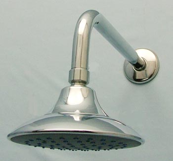

One other thing to check on the shower pressure is that they put restricters in them to limit water usage. Take the head off and do what you are inclined to with it.

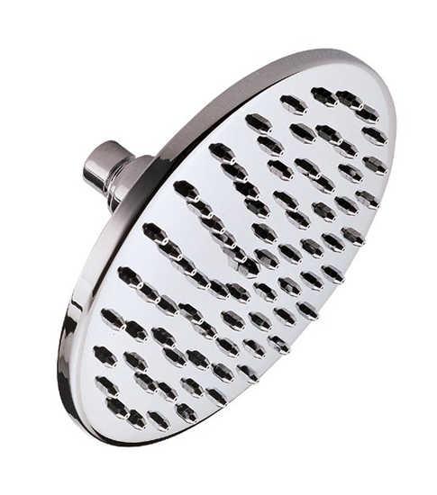

Wink DO What You are Inclined, Then...
Add one—or two—of these:
