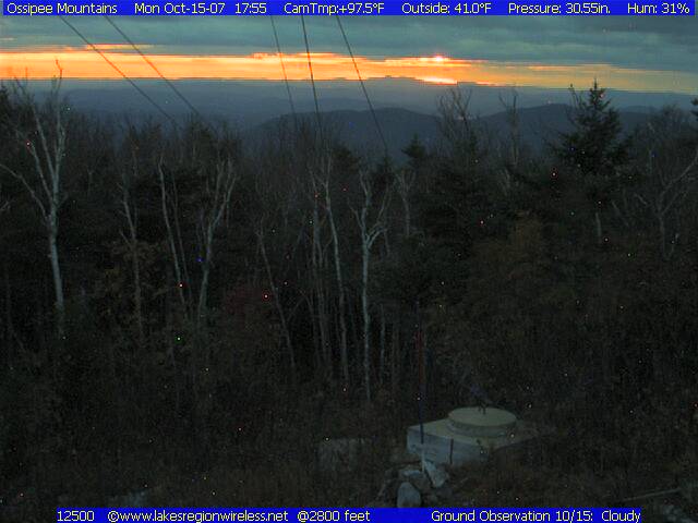

Old 10-15-2007, 05:10 PM   #10
mcdude's Avatar
Join Date: Jul 2002
Thanks: 374
Sunset tonight on the Ossipee Mt. Cam
