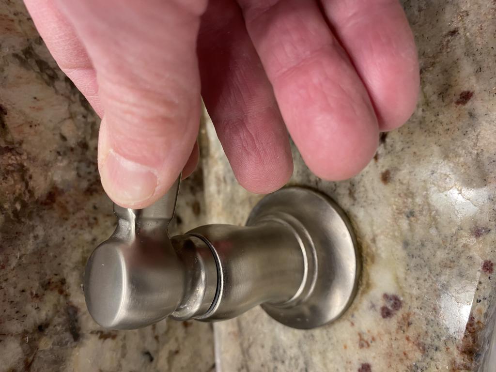

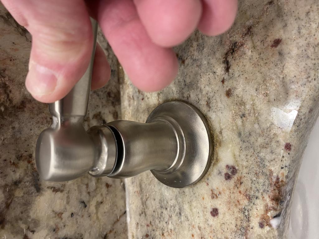

Here is my bathroom faucet. I am not sure of the brand and if I could figure that out I might be able to research my problem. As you can see the handle is loose and rocks back and forth. I expected to see a small allen head screw on the faucet that I would loosen and then reseat the faucet. But there isn't. If I push down on the handle it does not seat securely and the problem remains. Any ideas would be appreciated. Thank you.

I looked through the current offerings for Moen, and could not find a comparable handle form.
Also the Moen have the set screw like you expected.

Are there other similar vintage faucets in the house that might reveal a manufacturer? If you don't have a regular plumber, this may be an opportunity to start a relationship so you have a guy to call when you REALLY need one.
Beyond that, I'd try to identify where this came from via previous owner or previous tradesman. If I were DIY'ing, I'd shut off the water and remove/replace the faucet (always a good excuse to buy a faucet wrench or other tool not already in your shop). Once removed, you might be able to solve the issue with a few taps from a 3 lb. Chevrolet tool. LOL.

Try turning the base piece that is below the handle. I think it might unscrew and allow you to lift it and the handle upward. You should then be able be able to see what the problem is.

Take a good photo of just the faucet, without your hand in the way and do a google image search. It may take a couple of different views but there is a good chance you will get a positive hit

Thanks all of you for your help. I found it. I'm now about ready to crawl under the sink!
https://resources.kohler.com/webasse.../1144560-2.pdf

Sorry, looking at the picture, I didn't pay attention to the fact you were using a a widespread. I should have thought of the retaining nut under the counter top as a way to tighten the entire unit up.

I was able to release the fixture from below then take it apart. The screw that held the handle was under the faucet and just needed to be tightened.
