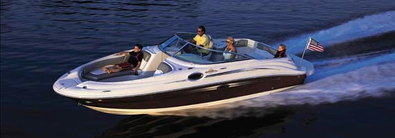

Default Sea Ray 220 Sundeck
I'm looking at upgrading to the Sea Ray 220 Sundeck. I currently have a Sea Ray 190 Bowrider that has been a great boat, but want more room to move about and take more guests..... I'm also considering models from Four Winns and Chaparral. Any opinions on the Sea Ray?

Great boat. You won't regret buying one. Perfect boat for the lake with 10 aboard or 2. The boat is alot of fun and can handle all the toys.

I bought a 220 Sundeck at the beginning of this season (new 2005 model). It has been great. A vey versatile boat. I use it on lake winni. and out on boston harbor. Lots of room for friends, but the thing that sold me on this boat as opposed to others was the little enclosed head. It really is a deck boat squeezed into a sport boat hull.

We got one a few seasons ago, and it is great. The high freeboard is great for our little ones, and it handles the chop very nicely. I am a big fan, but now that I have it, should have looked at the 240 more closely...

We also bought a SunDeck and LOVE it. I previously owned a Four Winns and Larson. All 3 were brand new and the 1st two were Volvo/Penta's ..... to date, I really can't complain about the Sea Ray or Merc.
This is a fantastic boat. Responds fantastically in rough water and plenty of room.
