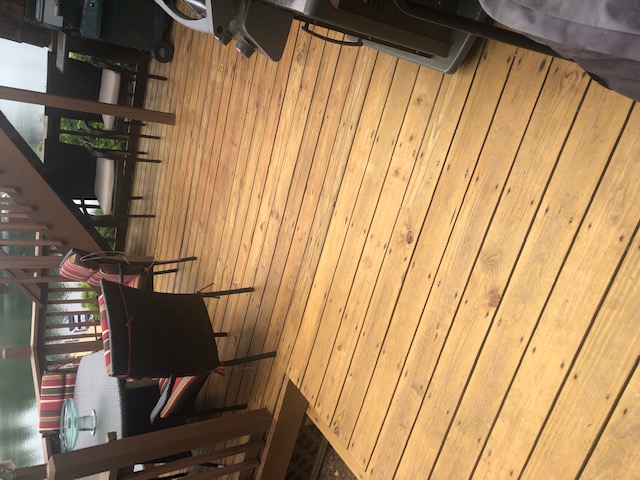

40 Year old pressure treated treated. Sanded and stained

Attachment 17614
Don't lose it. We can no longer get the same treating or even the tighter grain of the older product.
Can't even get the native exotic that had the stain pressure treated into the board anymore.
