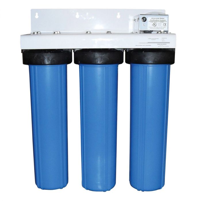

At the house I have the Pura uvbb-3 uv filter system but I use a regular pump and a pressure tank. The filter system has a charcoal filter, a sediment filter, and a UV chamber to kill bacteria. The water tests as good enough to drink. I left a Lowe's filter in line ahead of the Pura system because those filters are only about $7. I change them every couple of weeks with the hope that they catch a lot of the dirt before it gets to the Pura system. I have used Gould pumps and usually get over 15 years out of them.

Under the camp we have sediment and carbon filters followed by the UV system. Overall a pretty standard setup.
