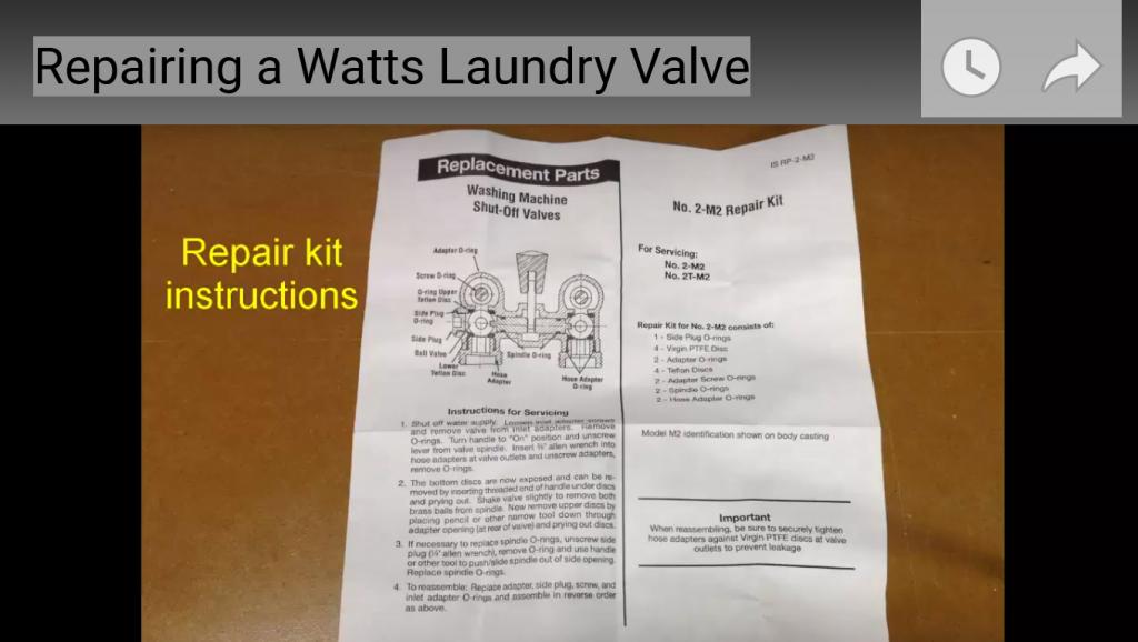

Alright, gentlemen, now that we've got a watertight roof, the oil company canceled the second bill for the smoke smell, and the car has new ignition coils, let's fix the washing machine shutoff valve. It's leaking around the handle in the ON position. It's a Watts-type valve like this: https://www.homedepot.com/p/Watts-1-...175C/205893456
I think I need to replace the O rings? I've looked for valve repair kit at the Home Depot website and I can't find it. On YouTube I found the diagram below, but I can't find this kit. Can anyone identify the kit at Lowes or Home Depot? Thank you very much!

Maybe try:
https://www.supplyhouse.com/Watts-08...SABEgJLUfD_BwE
or, of that does not work, buy a new valve and scavenge the o-rings out of it.

Good find, Randalnh. Thank you.
There's a great video here on rebuilding the valve using the repair kit:
https://www.youtube.com/watch?v=C1lvvHjG4EI
At the end of the video, a note says that rebuilding the valve is time consuming and you're better off buying a new valve! I'm sure that applies to me, with zero plumbing skills. I have replaced the O rings inside the hoses before but I didn't go beyond that. Apparently when the valve is leaking in the ON position you have to disassemble the whole thing and replace the O rings and teflon disks.
Repair kit: $23. New valve: $35. I'll get a new valve.
