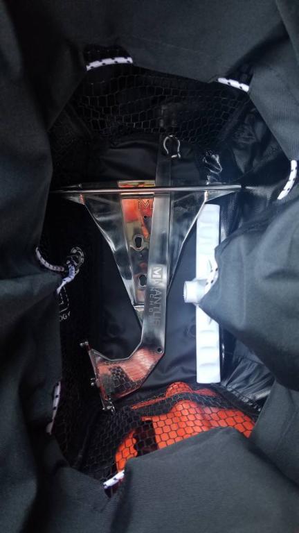

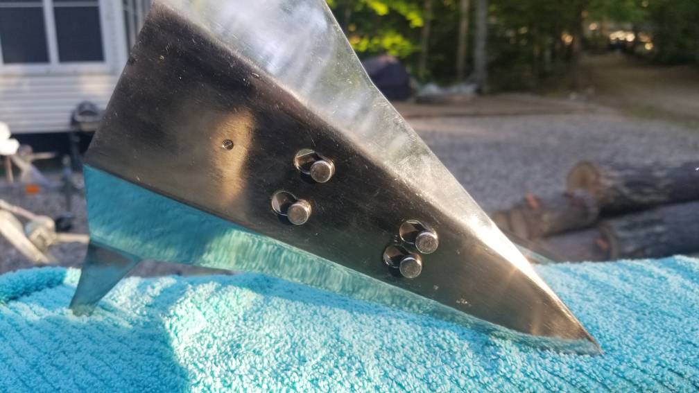

Ok, so I decided to just suck it up and buy the Mantus Dinghy Anchor (the Fortress linked above was just too big and required more assembly than I'd want to do).
I then discovered that NO ONE has them in stock, not even Mantus. Through my (exhaustive) research, I found one in a Maryland marine shop, and it's on the way—I should have it Friday!

What did the anchor end up costing? I am looking at Fisheries supply for $152
dva is offline   Reply With Quote
Cost me $160 shipped two day, so I could have it by the weekend.
Note, though, that there are a few versions:
Old: galvanized one piece and stainless two piece (fixed bar across fluke).
New: stainless three piece with roll bar (like their full-sized anchors).
The one I bought is the older, two-piece stainless version. I'd had a one-piece galvanized before that I sold to a friend—while on a ride the other day, I double-checked sizing and it's too big for my direct access storage compartment.
So, $152 shipped is a fine price. The kit, which comes with rope, shackle, and bag can be had for $185 shipped. I bought rope and a shackle online for $25, so I'll break even but I kinda like the one less part of the two-piece (though I'm thinking the new roll bar may help overall).
Sorry for the long answer!

Like a glove!Name:  20200529_185901.jpg

Old 05-29-2020, 09:26 PM   #26
8gv
8gv's Avatar
Join Date: Jan 2012
Posts: 2,098
Thanks: 64
Thanked 745 Times in 479 Posts
Do you have to assemble it for use?
More pics please.
8gv is online now   Reply With Quote

Old 05-30-2020, 05:48 PM   #28
thinkxingu
thinkxingu's Avatar
Join Date: Jul 2014
Posts: 6,268
Thanks: 1,173
Thanked 2,072 Times in 1,286 Posts
Here you go.Name:  20200530_184551.jpg

Old 05-30-2020, 07:29 PM   #29
8gv
8gv's Avatar
Join Date: Jan 2012
Posts: 2,098
Thanks: 64
Wow!
That looks like a Medieval weapon!
Try not to impale any lake monsters.
