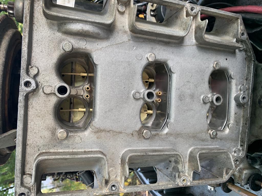

Next round! My engine started beautifully and kept running this time, however gas kept pouring out of the hole in the top hole front face between the 2 carburetors, mostly the top carburator. The primer hose goes into the top of each carberator. I did change the primer solenoid parts, not the whole solenoid. The gas kept flowing down the front face.
I checked the compression again after it ran, full throttle, and each cylinder was once again 60psi. I will admit the compression kit is from harbor freight.
I may be at my limit here, but I'm close.
Sorry the pic is upside down.

I do not understand where the gas was pouring from based on your description, but it sure sounds like nothing more than a sticking float in the carburetor that was dumping fuel. If I am right, the bowl probably has some ethanol-caused crud in it. I would clean all the carbs if it were my engine. I don;t know of any additives that will dissolve the crud, sad to say. I imagine youtube would be a great resource for instructions about carb cleaning.
Fix the fuel leak and test run it. If it makes adequate power, use it and don't worry about the compression. You are smart to not trust the HF tester. They make some great bargain tools (and their best tool boxes are fantastic), but anything from them that has to measure absolute values is suspect. I doubt there's any way to trace the calibration of that compression gauge back to a standard. It's a good tool for checking for differences in compression between cylinders though and the fact that you saw none is an excellent sign.

The picture is upside down but the fuel is coming out of the hole in the center of the top carburator. I believe this hole is from the top where the prime tube is attached
Everything was stripped, dipped and soaked in cleaner, new gaskets, floats, needle, gas lines.
Could the primer solonoid keep priming?
I doubt it's the primer solenoid, that would affect all three carburetors and it cannot force fuel into a carburetor (it's just a valve that lets extra fuel in when the engine is so cold that the fuel comes out of suspension which makes it hard to start).
The fact that the floats and needles were changed means it's even more likely something went wrong with the float and needle. They are quite fiddly and easy to screw up, and if you know anything about part failures and "bathtub" curves", a brand new part has a higher likelihood of failure (infant mortality) than one that's been proven to work over time...
Pull off the carb that's leaking, take the bowl off and see what's up. My guess is that the float has fuel in it, the needle valve has a defect in the rubber tip, the clip on the needle fell off, the pivot shaft is displaced or the stamped metal hinge lever is bent (which typically results in incorrect float height).

Originally Posted by Denny Crane View Post
Thanks one again for seeing this thru! The picture is upside down but the fuel is coming out of the hole in the center of the top carburator. I believe this hole is from the top where the prime tube is attached Everything was stripped, dipped and soaked in cleaner, new gaskets, floats, needle, gas lines. Could the primer solonoid keep priming?
It's likely the float that's jammed open, allowing gas to leak out.
Gently run a clean probe through the large single hole that's leaking, gently tap a few times, and see if that clears the jammed float.
You might even feel the float return to normal.

My 1985 Evinrude 175 lives on! Thanks Dave R and all who walked me thru different steps and ideas. I ended up taking apart the top carburetor that was leaking and the new float wasn't dropping enough. My manual said it should drop between 7/8-1 1/8" so I made the adjustment. It started with the first turn of the key and kept on running! I was ready to buy a new fuel pump earlier so you saved me over $400 for just that part. I don't mind tinkering with an old engine if I can get more time out of it. I think I'm at my limit mechanically so if anything else comes up it might be the end! Thanks again.

The next obvious check was the carburetor. We took it off, took it apart and found lots of crud. There was one particular chunk of crud blocking the pilot jet completely (problem 7) and when we removed it, put the carb back on the engine, and cranked it, it fired right up and the genset has worked great ever since.
We put a new diode on the solenoid the next day and added a fuse so that it cannot cause the same problem again. We also got rid of the water in the fuel tank.
That's my idea of an interesting evening. FWIW, I had only recently learned about arc suppression diodes this year, on the internet, and if not for that, I think we would have never got past problem 2, that night. I also just happened to have a bag of 100 spare diodes on hand (that I got on ebay for a couple of bucks) because my 27 year old boat has them installed on every one of the dozens of switches and relays.

It would have been too easy if my outboard story ended there. The engine was running beautifully in my driveway and I was planning to winterize it when it stopped out of the blue and I couldn't turn it over again. When I went to prime it again I noticed the prime bulb was compressed and I couldn't return it back to normal. Any ideas?
Denny Crane is offline   Reply With Quote

I know where the vent is but I don't know how to check that.

It's either a clogged vent on the fuel tank or a clog blocking fuel from flowing from the pickup in the tank to the bulb. The clog cannot up downstream of the bulb.
Assuming it's not a clogged vent, one common cause of this is a blockage in the fuel line caused by de-lamination of the inner layer of fuel line itself. If the fuel line is more than 10 years old, consider replacing it.
It may also be caused by crud clogging the fuel pickup in the tank. Pull it out and have a look.
There may be a check (anti-siphon) valve where the fuel line comes out of the tank. Check that, might be stuck shut.

Great ideas once again. I changed all the fuel lines from the gas tank out a year or two ago. Come to think about it when I went to siphon the old gas out with a small 12v pump I had trouble pulling gas at first. I may try an external gas tank first and go from there. Thanks!

If there was any sign of water in the old gas, I bet the check valve ball is rusted and sticking in place.
