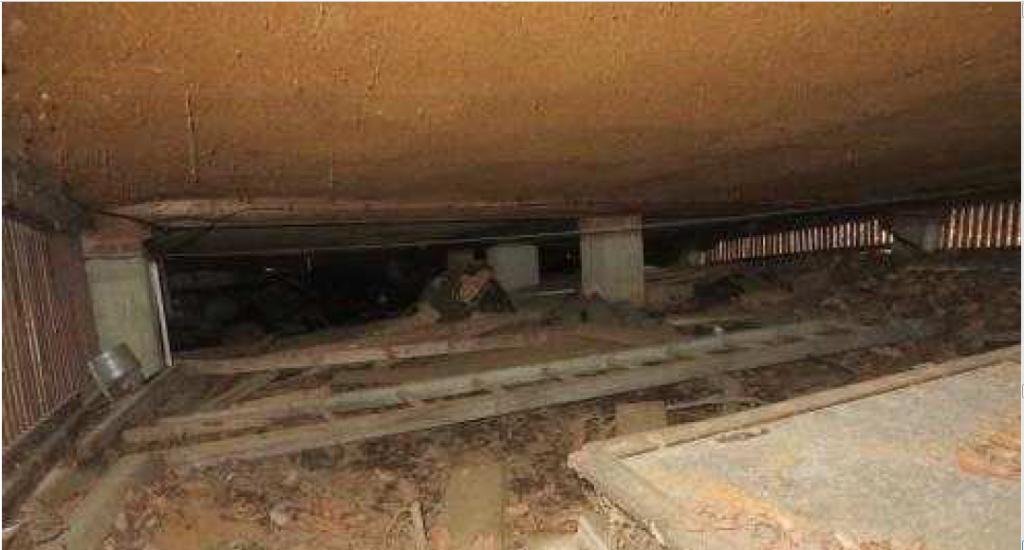

Default what it looks like
This runs to ground/grade at the back upper corner.

Looking at those pics, if that were mine I would probably lean towards insulating the perimeter walls with rigid and laying a poly vapor barrier on the ground.
