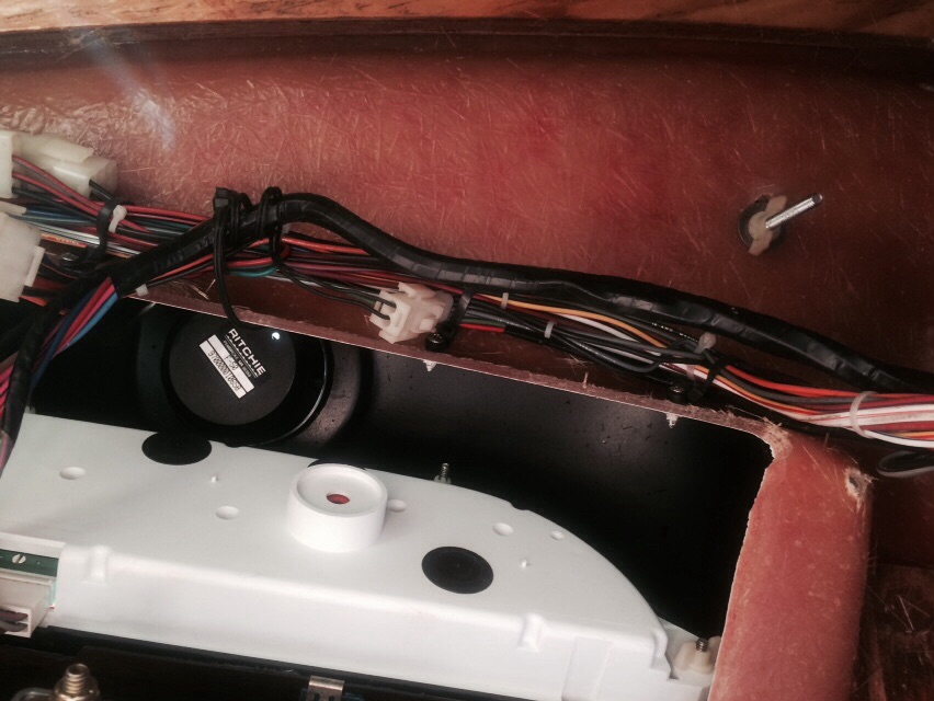

I have an old (1998) Four Winns Horizon 200 that has a flush mounted Ritchie F-50 compass on the dashboard. The issue is that over the last couple of years the compass has leaked out (for some unknown reason) most of its liquid and has stopped functioning accurately. I see on Amazon that I can still purchase the identical unit for around $55 and thus I'd like to replace the original unit with one that will actually tell me what direction I'm heading. Prior to ordering the new compass I thought that I'd perform my due diligence and see how easy getting the old unit out is. Here lies the problem! Using a small offset Phillips screwdriver I was able to remove the three screws connecting it to the dashboard ..... but .... when I tried to lift the unit out I found that it couldn't be removed due to its proximity to the windshield. Doh!!! In looking at the dashboard and instrument cluster it appears as if the slightly darker (in the picture) vinyl covered fiberglass sheath the holds the compass, instrument cluster and toggle switches should be able to be removed enough to get the compass out but I don't know how to do it! Looking under the dashboard doesn't offer an obvious remedy ..... does anyone have experience in doing this and can help me find the under dash connection points?? In the second photo, one of two long bolts with wing nuts is visible (right centerish) that look like they "might" be at least part of the solution ..... But I don't want to just start taking things apart and end up with a boat that doesn't work. Help, please!

Here's the second photo

Posts: 1,944
Thanks: 544
Boat dashboards are usually pretty easy to remove as a complete unit, the trick is just finding the right screws (duh).
The screw in your second pic looks like where I would start. Loosen those, see what moves, look around the areas that don't seem to be moving and repeat.
FWIW, I'd order the new compass now. Most likely by the time you get the dashboard loose you won't want to put it all back together and then remove it again. Amazon has pretty good return polices, on the 1% chance you can't make it all work you can just return the compass.

My Four Winns dealer had to remove some glue that was in a similar position as your compass, and he removed that section of the windshield. The rubber strip at the bottom of the windshield on the outside hides the screws. It should be easy enough to move it enough to replace the compass without a complete removal of anything.
Agreed, the windshield comes off in 10 minutes.
Island-Ho: It's been ten months since posting this request for help to replace my Ritchie compass in my Four Winns. I bought the replacement compass over the winter and finally got around to trying out your advice this afternoon. You were spot on as to how to accomplish the windshield partial removal! I can't thank you enough for your advice ..... the whole project took me less than 30 minutes. Now I wonder why I procrastinated so long! Thanks again.
