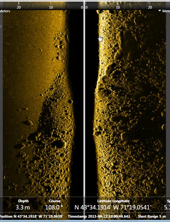

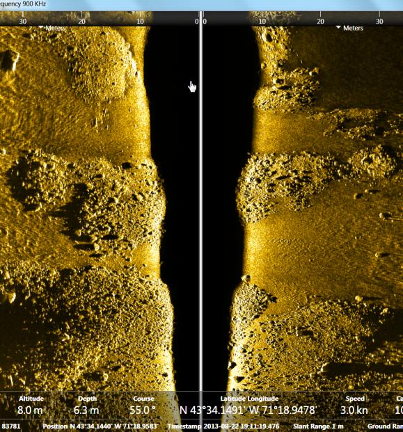

The bottom of Winnipesaukee varies greatly. Unless you've dived it you really don't know just how varied it can be. From huge plains of plain mud to house sized boulders to gravel beds to boulder fields to embankments that drop off very rapidly into deep water (East Rattlesnake for ex.), I never really know what I will see when I start to scan.
Some terrain shots are attached, most taken at very low altitude meaning the towfish is flying close to the bottom. Flying low has certain clear advantages, and certain dis-advantages. Slamming the fish into a rock or drilling it into the bottom are two of them.
The white line down the center of each image represents the boat path and the wake. When the bottom closes in towards the white line the depth is changing-getting shallower. Sometimes really fast.
- Image 1: Bottom changes from small boulders and gravel to mud;
- Image 2: Bottom comes up then down then up again; Towfish is really close to the bottom-really close;

All images can be zoomed in on for better clarity.
