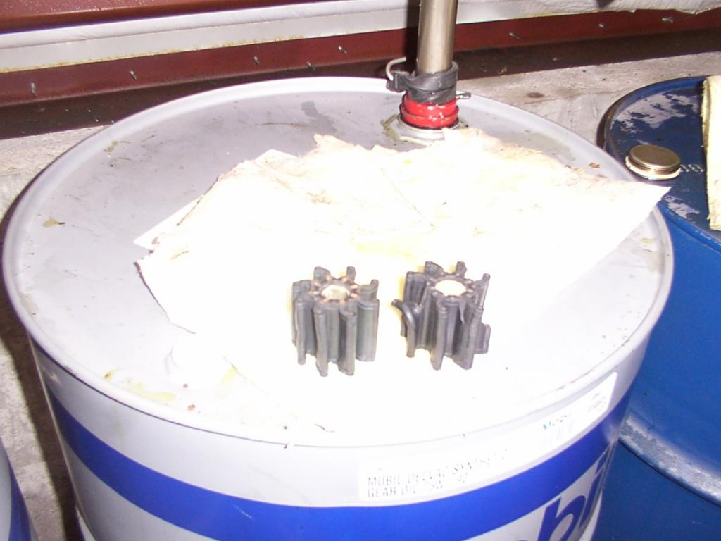

My 350 V8..Alpha 1 has been around since 1986. The engine has 680 hours. The engine circulating pump has never been replaced. No need. The ALPHA (rubber impeller) pump was replaced ONCE in 20 years.
The drive was replaced three years ago with a brand new drive. Pump included IN the new drive. NB

FWIW, I have my impeller changed every 2 years as recommended by Volvo Penta per my marina. Never had a problem, impellers look aged after two years. 8.1 DP

FWIW, you are pushing the envelope in an Alpha 1 drive by only replacing the impeller once in 20 years. Pretty cheap insurance for a $35 part.
I do almost all my own work. When I bought the boat it was 10 years old. I was getting older and figured it was about time I sat back and let someone else do the work.
The boat yard replaced the gimbal bearing, realigned the engine, replaced the water pump in the Alpha, and changed the lower unit oil. The bill came to $715. I had expected a bill of around $300 or so. I had asked that they "save" all the parts they replaced. They did. It was their indictment.
The boat only had 125 hours on it from new so the gimbal bearing was of course perfect. I Know what a "good" bearing Feels like. I started asking questions and it went down hill from there. The fellow threatened to call the cops.
I PAID the bill and collected my boat and drive and left. If I hadn't, they were going to "Hold" the outdrive as security until I did. I considered that episode an education. Education isn't free.
SAD to say, I have had an attitude toward mechanics ever since, and I went back to doing my own work. NB

Thanked 142 Times in 79 Posts
Default bravo impeller
Here's the pump and impeller. The spindle is similar to the blade spindles on a lawn tractor, and the bearings can fail in a similar manner. The impeller housing is plastic and bolts to it. It can be very difficult to access depending on the brand of boat. You can see two old impellers. The fins become brittle as the rubber dries and hardens and break off with time as you can see. When they break off the pump partially works for a short time before it disintegrates. The pieces can end up in the thermostat housing and block the flow of water to the exhaust manifolds which can crack. Definitely less expensive to pay ahead on preventive maintenance let alone the possibility of getting stranded and having to get towed on a beautiful summer day.
mowtorman is offline   Reply With Quote
Old 01-18-2013, 05:07 PM   #29
Dave R
Dave R's Avatar
Join Date: Jul 2004
Posts: 2,984
Thanks: 246
Thanked 743 Times in 443 Posts
The 496 pump as described by the OP is different than that one. Advice still applies though.

BTW: Running an Alpha I without water will burn/melt the impellor in less than a minute. I'm not making this up. I learned this by doing. NB

Default Nice pickup
On the 496. The one shown is a 350 bravo but with basically the same internals and the same issues.
The bottom of this page shows the three Bravo pump styles: http://www.sterndrives.com/rebuild_b...waterpump.html You (assuming that's your pump in the picture) and I have the middle style pumps (I have a 7.4 MPI).
