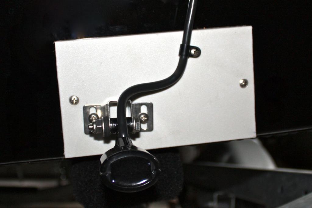

Jonas Pilot
Join Date: Apr 2005
Thanks: 1,047
This is how I installed the transducer for my Lowrance® HDS-5.

Jonas Pilot
Join Date: Apr 2005
Thanks: 1,047
I've had plywood and polypro transducer mounting plates. If you use the correct adhesive you won't have any problems with leaks. By using a mounting plate you reduce the chance of damage to your transom if you were to run over something that hit the transducer. This is how I mounted the transducer for my Lowrance. Note the loop in the cable. This extra length could save your cable in the event of a strike on the transducer.
