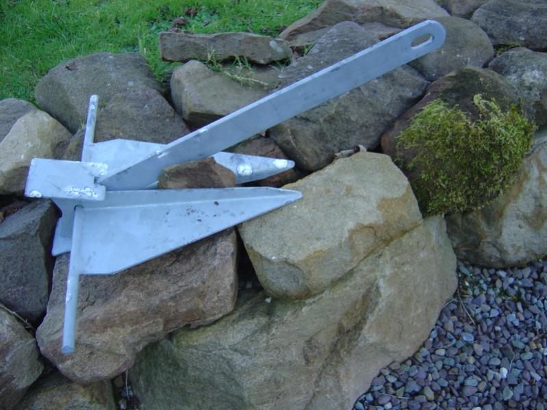

I didn't know what a Fortress Anchor was, turns out we have two.
This is what it looks like for those of us who don't know the names.

But then when I looked for a picture of a Danforth Anchor I knew I was in over my head. So what's the difference?

From what I can tell RG,a Fortress and a Danforth are both fluke style anchors.I think its a little akin to Kleenex as both are the manufacturer name of a fluke style anchor and have sort of taken on the proper name as the type of anchor.Did that make any sense?

Danforth and Fortress are both brands that employ the same basic anchor design concept (fluke)
Most people consider the steel welded Danforth to be superior to the lighter weight aluminum Fortress that is bolted together.
Both have pros and cons, and since most people on the lake are not anchoring overnight or for extended periods, it's probably a draw.

I stopped using Danforths about 15 years ago, finding that Fortress anchors are far superior. In most anchoring situations their ease of use and holding power are great. Although most of our boating takes place in the ocean, Fortress anchors have worked well for us on Winni, too.
For exposed overnight anchorages in the ocean I use a CQR anchor. This heavy duty anchor, by the way, was found in some rocks in ten feet of water while I was snorkeling near Bear Island. It was in excellent condition and sold for about $150 at West Marine! Someone must have been in a real hurry to leave it behind. Don't even THINK about claiming it was yours! http://www.winnipesaukee.com/forums/...lies/smile.gif

It is mine. I lost it near bear. I can describe it too to prove its mine: galvanized steel, hinged shank, a little rusty, plow on one end and a hole on the other end, plow is a bit scratched. May or may not have been found with my chain attached. Found jammed under a rock. I was in a real hurry.
