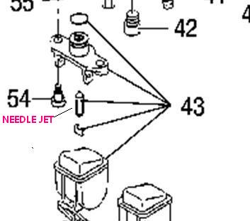

Does anyone know if the needle should come up out of the port from the main jet, or should the tip remain hanging down into the hole slightly? I don't have any machines here I can check.
If this is the valve on the float in the bowl of the carb then this a totally different out come. Clean and adjust the float along with the rest of the carb and your in good shape. The more I think about it, it's probably the float, but if rather be safe than sorry.

If I recall when I updated my 550 after it blew chunks there are the main and needle jets, then the needles themselves. The needles do not clear the jets completely at WOT. At the time I was fixing mine the jetting was the only fix they recommended, now they are doing a whole kit that includes a whole lot more. If you would like to read more about it there are ample write-ups on the problems and fixes from Polaris... here is just one of many

Post Needle & Seat ?
NEEDLE & SEAT?
This is the "valve" that "Hangs" on the Floats. It can "swing" and stick as described in the repair applied. Not that common.
Polaris had some problems when they used a Brass on Brass Needle and Seat combination. Between normal or admormal ware the fuel could seep through and cause Hard starting or Flooding after not running from one day to the next. The simple fix was to, after riding Shut the Manual Fuel Valve OFF. Easier sead than done.
The real fix was to replace the "Brass Needle" with a Viton Tipped Needle. The Viton Tip is a "rubber tip. They will virtually never leak. They were a little expensive, especially if you had a "Triple", at $25.00 each.
The actually swapping of the Needles was easy once you removed and disassembled each Carb.
