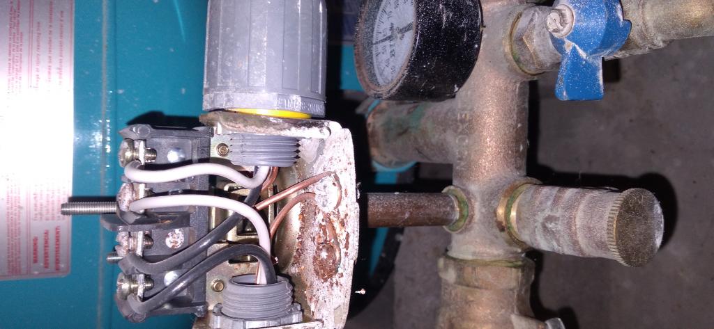

Problem has been identified ! I believe the pump 'pressure switch' is the issue.
Pressure switch is mounted on a 1/4-in tube near the pressure tank.
I was able to trouble-shoot the cause and solution from this website.
https://www.familyhandyman.com/proje...nd-diy-repair/
I have attached a picture of my pump switch. The 1/4" pipe I tapped is shown below the switch box.
They stated that if banging on the tube under the pressure switch kicks on the well pump, it means the contact surfaces of the electrical contacts are pitted or burned, on the pump switch causing a poor connection.
So I banged on the 1/4-in tube under the pressure switch, and darn if that do the trick. Water flowing again as normal. Wife happy again !!!!
I'll check the switch contacts for pitting and burning, and clean all electrical contacts, with nail/emory file. Will contact a plumber/electrician to replace pressure switch. Switch are fairly cheap, it will be the labor that will cost.

You should pretty much be okay to replace the pressure switch with a new identical pressure switch as opposed to hiring a $250-electrician to do it.
For unscrewing the 1/2" diameter round collar nuts that hold the metal housing to the conduit use a medium flat screwdriver and a hammer and just tap-tap-tap the two around counter-clockwise and the two collars will come unscrewed.
Just make it all identical to what's there now and don't mess with the setting on the new $30 pressure switch.

Mine started out as that...
Then after changing that out it was determined that the wires running down the well to the pump had corroded causing the switch to ''fuse'' open.
Daniel's jumped the wire (cut out the old and tied in with new wire), taped it back up tight and replaced the torque arrestors.

In the meantime I popped off pressure switch cover (power off of course)
and cleaned the 4 contact points with emory board, and a little 100 grit sandpaper. I noticed some pitting on points, so cleaned them up.
Hopefully be OK until I get new switch installed.
Reminds me of cleaning the points in my car distributor, back in the day, same principal.
Thanks again !

Make sure the 1/4” pressure hose is clear too. Mine used to get mucked up, blocking the pressure from the pump side to the switch. I reamed the gunk out with a small piece of wire .
