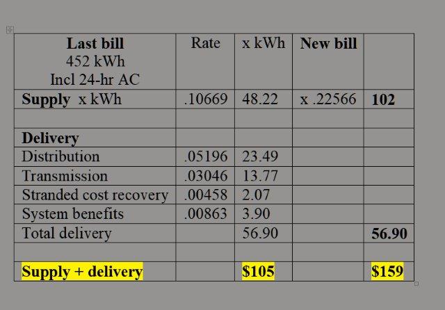

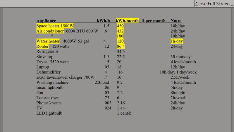

I'm reposting this question from the closed thread because I think it was on topic and concerns the Lakes Region due to upcoming large rate increases.
Q: What are the biggest ways we can reduce our electricity consumption substantially? I don't think that eliminating trickle charges is going to make much of a difference if the bill doubles.
My biggest dilemmas are air conditioning and dehumidifiers. I work at home and have to have a cool environment. My house is very humid in the summer. The dehumidifiers (second floor and basement) use a lot of electricity.
One solution I'm considering is using only the ground floor of my house. That way I wouldn't have to use the AC upstairs at night. I could just continue cooling the downstairs, which must be more cost effective than cooling down the very hot second floor at bedtime.

1. Change ALL of your lightbulbs to LED... they even make LED replacements for the halogen bulbs in track lighting...
2. Get yourself a smart thermostat... I use a NEST and it has a great ECO mode for running the AC.
3. Get rid of all the small vampires you can... any small charger is almost always using some electricity. I have my phone/watch charger on a power strip that I turn on/off as needed. Same for my laptop.
They make wifi enabled AC units & dehumidifiers.... that will help save $$ too.

There are a few key components in any household that should be examined...
1. How old is your refrigerator and how well does it seal, when closed....
2. If you have an electric dryer, how old is it...
when shopping for new appliances look at energy star ratings.
Now look at the little things:
- Replacing Light bulbs wiht LEDs
- make sure computer monitors are shut off when not in use
- ensure lights are not being left on...
There are lots of things that have been done... Over the years I have fiddled with many ideas..... the 2 key components I list above are really the two main hitters, that cost people....

I agree with the energy audit as it should give an indication of most bang for the buck on various options, and which items you can do yourself.
How do you heat water? Electric? Get a timer. Cheap and effective.

An energy audit is a great idea. If you can't arrange that...
There's a doodad called Kill-A-Watt that you can plug in between something and the wall outlet. It will tell you how much electricity that thing is using. Useful for figuring out what things are costing you, and what things aren't.
Some libraries have these available if you don't want to buy one.

Have you had an energy audit completed? I would absolutely suggest that, if not. Though you might not jump in to big projects, they'll give you an overall assessment of your home's energy use and ways to reduce it. My second thought, in terms of the coolness, might be an attic fan—those are inexpensive to install and surprisingly effective and efficient. Finally, have you thought about downsizing? You've posted a lot about repairs and needing to shave costs and all these extra floors/rooms that I can't help but ask.
Yes, I had an energy audit about 20 years ago, for heating rather than cooling. At that time, upon advice I had the insulation in the attic replaced and cracks sealed throughout the house. It was blown-in insulation. Honestly, the upstairs and attic got a lot hotter and more humid after that. For a later renovation I had the blown-in insulation in half of the attic replaced with foam panels for a cathedral ceiling (yes, used proper ventilation strips). When I got the roof replaced last year I had ridge vents installed the whole length of the roof. An attic fan is worth investigating, thanks.
Have I thought about downsizing? HA! Constantly. I want to own an energy-efficient house around 850 sq ft. Something like this: https://www.architecturaldesigns.com...e-plan-68574vr

I have analyzed my appliance use and came up with the following:
Name:  Screenshot (268).jpg
What stands out:
  • Need to be careful with the space heater in the winter
  • Air conditioning cost can be reduced by more than 50% by not using it at night(using a fan instead). I've tried that for the last 3 nights. Not fun.
  • Water heater uses significant electricity compared to air conditioner. That's only for 1 hour a day.
  • Modem/router consumes a surprising amount of electricity. Can't really turn it off at night because the modem is downstairs but Roku nighttime TV is upstairs.
  • Refrigerator uses a surprisingly small amount of electricity compared to the top consumers. Hope I calculated it right.
  • Dehumidifier is a top consumer, but doesn't need to be used every day or all day. Once the humidity in the basement is lowered, it's good for several days to a week.
  • Other items are much smaller consumers of electricity. Every little bit helps, but, for example, changing from incandescent to LED lightbulbs isn't going to lower my electric bill significantly. LED bulbs are hard on light-sensitive eyes.
QUESTION: How can I figure out my new monthly Eversource charge using the above chart?

Old 08-02-2022, 11:45 AM   #38
FlyingScot
Join Date: Jun 2016
Posts: 2,030
Thanks: 1,009
Thanked 860 Times in 532 Posts
Originally Posted by SailinAway View Post
[*]Modem/router consumes a surprising amount of electricity. Can't really turn it off at night because the modem is downstairs but Roku nighttime TV is upstairs.
There are a wide variety of automatic switches available, from very simple ones that will turn off and on the power at the wall outlet to your modem at preset times every day, to programmable via iPhone/Android. The simple ones are available at any hardware store, the complex "Smart Home" (or something like that) at Best Buy.
FlyingScot is offline

Old 08-02-2022, 12:18 PM   #39
LikeLakes
Join Date: May 2021
Posts: 314
Thanks: 44
Thanked 86 Times in 62 Posts
I would re-visit your thoughts on LED bulbs. You save around 50 watts by replacing a 60 watt incandescent with an LED. Let's say you have 6 different lights on, some for 4-6 hours per day, some more. It's a fair amount of energy saved. I've used several brands, have found that Phillips soft white LED's have light that is very similar to incandescent, and I've never had anyone say they were hard on the eyes.

Old 08-02-2022, 01:44 PM   #40
SailinAway
Join Date: Apr 2019
Posts: 989
Thanks: 255
Thanked 279 Times in 168 Posts
OY! My father worked for the electric company so he was hyper aware of excessive consumption and the cost of electricity. The rule in our house was, "One person, one room, one light." He would go around the house checking for violations and fine us 10 cents if we had more than one light on. I still follow this rule today.
LEDs emit an amount of blue light that is hard on the eyes, especially for older people with cataracts. I will check out the Phillips soft white bulbs, thanks.
https://www.oledworks.com/news/blog/...ght-from-leds/
SailinAway is offline

Old 08-02-2022, 07:14 PM   #45
John Mercier
Join Date: Jun 2021
Posts: 2,057
Thanks: 2
Thanked 387 Times in 322 Posts
Attachment 17694
What stands out:
Your space heater and AC would be more intermittent than some of the other items that are used each and every day.
But for the space heater... you may want to think of an electric blanket/throw/pad.
John Mercier is offline
Old 08-03-2022, 07:16 AM   #46
brk-lnt
brk-lnt's Avatar
Join Date: Aug 2007
Location: South Down Shores
Posts: 1,920
Thanks: 518
Thanked 561 Times in 329 Posts
I think you've over-estimated the power draw of your router by a factor of 10. Unless the router is also serving as a hotplate there is no way it is using 120Watts.
[insert witty phrase here]
brk-lnt is offline
Old 08-03-2022, 07:45 AM   #47
SailinAway
Join Date: Apr 2019
Posts: 989
Thanks: 255
The specs are here: https://us.comtrend.com/ar-5381u/
If I'm reading it right it says 1 amp, which would be 120 watts?
Old 08-03-2022, 08:14 AM   #48
brk-lnt
brk-lnt's Avatar
Join Date: Aug 2007
Posts: 1,920
Thanks: 518
It's 1A at the 12VDC output from the power supply, so 12 watts. And even that is more likely a peak value and not a constant value, realistically the average power consumption of it is likely under 10 watts. Your calculation then was essentially a yearly operating cost, not a monthly one.
brk-lnt is offline

Old 08-03-2022, 11:32 AM   #50
SailinAway
Join Date: Apr 2019
Posts: 989
Thanks: 255
Thank you very much for clarifying this! I hope there are no similar errors on my list?
Old 08-03-2022, 11:35 AM   #51
SailinAway
Join Date: Apr 2019
Posts: 989
Thanks: 255
I would still like to know how to estimate my new monthly Eversource cost for the top items on my list. If I know the kWh per month of an appliance, how can I calculate the cost?
Old 08-03-2022, 11:45 AM   #52
brk-lnt
brk-lnt's Avatar
Join Date: Aug 2007
Posts: 1,920
Thanks: 518
Multiply your monthly estimated usage by the fully-loaded costs. By fully-loaded, I mean taxes, other fees, etc. Your stated KwH rate for electricity supply is not the full cost of your electric service.
For example, if you estimate 400 KwH of electricity usage in a month, and your fully-loaded KwH supply charge comes out to $0.22 per Kwh then your estimated bill would be 400 * $0.22 = $88.
Conversely, if you eliminate 10 KwH of usage through various reductions, then you can estimate the savings the same way, 10 * $0.22 = $2.20 in savings.

Old 08-03-2022, 12:42 PM   #54
SailinAway
Join Date: Apr 2019
Posts: 989
Thanks: 255
But . . . we don't have the new Eversource rates yet.
Old 08-03-2022, 12:46 PM   #55
brk-lnt
brk-lnt's Avatar
Join Date: Aug 2007
Posts: 1,920
Thanks: 518
I thought that was published as $0.22 for supply, but maybe I'm mistaken.
Some of the fees are not increasing, just the supply rate. It sounds like the net effect will be about a 50% increase in your overall utility bill for an average user.

Old 08-03-2022, 01:36 PM   #56
thinkxingu
thinkxingu's Avatar
Join Date: Jul 2014
Posts: 5,608
Thanks: 1,126
Thanked 1,809 Times in 1,113 Posts
$.22566 is the current Eversource SUPPLY rate, up from $.11xx.
For someone using 450kwh/mth., the bill would go up ~$52.
If I didn't change to a new supplier, my highest bill last year would have been something like $250 more.
With the new supplier, that will be more like $100 more, which is better than the alternative but still blows.
Sent from my SM-G990U1 using Tapatalk

Old 08-03-2022, 03:45 PM   #57
SailinAway
Join Date: Apr 2019
Posts: 989
Thanks: 255
Thanks for that information and to brk-Int for his explanation. I think I have this figured out, IF the supply charge is the only rate that changes. Here's my last bill, when I used air conditioning 24 hours a day:
Name:  Screenshot (269).jpg
Does that look about right? That's very helpful. My actual usage on my July bill was 260 kWh less than my chart estimated.
Old 08-03-2022, 04:01 PM   #58
thinkxingu
thinkxingu's Avatar
Join Date: Jul 2014
Posts: 5,608
Thanks: 1,126
Attachment 17703
Our electric bill is IDENTICAL to yours—we used 456kwh from 6/16-7/18.
We're in a 2100 ft² split built in the late 1970's.
Central air, dehumidifier, electric stove, electric dryer, etc. AC set at 72° for all but while away, which was 75° and water heater set to 120°.
The three things I'm currently trying (as I type this by the lake): dehumidifier set to 60 instead of ~45, water heater set to vacation mode while away, AC set to 85 while away.
The killer for us is electric baseboard, but we've never changed for a ton of reasons. Though I think we can minimize/negate the price increases, I may look more into heating this next year.
thinkxingu is offline

To that 0.4 KWH/hr of electric input turned into heat by the dehumidifier, add about 0.3 KWH for every pint of water ("a pint's a pound, the world around") condensed by the unit.

I just got my Eversource bill. Compared to September last year, I've reduced my electricity usage by 67%! The bill was $76 for 199 kWh. The August bill was $134 for 454 kWh. This is before I switched to Direct Energy as my cheaper supplier, which should be reflected in my next bill.
In August I (like many Americans and especially here in New Hampshire) suddenly became aware of the full meaning of inflation and I brainstormed and studied all the ways I could find to reduce expenses with electricity, telephone, internet, gasoline, heat, water, and home maintenance. I calculated the kWh of each electrical appliance in my home. I tracked my money-saving actions each day, which added up to 48 actions in one month. A sample:
  1. Turned off the 53-gallon family-sized water heater
  2. Lowered phone and internet bill from $1500 a year to $627 by dropping the Consolidated Communications landline, signing up for two years of unlimited Tracfone for $199 a year, and talking Consolidated into giving me their new-customer rate of $36 a month including fees for internet-only service
  3. Reduced use of air conditioning and dehumidifier sunstantially
  4. Changed lightbulbs to LED
  5. Recycled water from the dehumidifier

  11. Bought a new electric lawnmower, snowblower, and other yard gadgets (brush blade for the string trimmer) so I am no longer dependent on expensive and unreliable workers
  12. Dry the laundry outdoors and put in it the dryer for 10 minutes to get the wrinkles out
I still have quite a few things left to do, like finding the best way to get hot water for the shower, changing my Medicare advantage plan, and finding someone to split a recalcitrant maple tree.
I realized that I was living as if I had unlimited cheap resources, with no real mindfulness about how much I was using, even though I'm normally frugal. That's not wise environmentally or financially. Simply becoming more aware of what I'm using and how much it costs has made a big difference in my expenses.
Utility companies make if so difficult to reduce costs that probably most of us can't face the amount of time it takes to do the research and negotiate with the companies. By the way, thanks a million to Thinkxingu for doing the research on energy suppliers and sending me to Direct Energy. It sure feels good to be depriving Eversource and Consolidated of their exorbitant increases.
