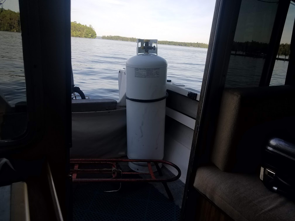

Although electricity has gone up, propane service delivered to the islands is expensive as well, and not always easy to get. Unless you are lugging your own 100lb tanks back and forth, there is one game in town for propane delivery. LWIPM does it, and I have heard of people waiting a long time for it.
We only use propane for our range. Our recent remodel uses an electric water heater. We have 1 x 100lb lowboy cylinder that I can haul myself if needed with a dolly and my good friend Steve's pontoon
We put it in last May and still have 40% left. Guaranteed if we were using it for hot water we would already be into another tank, or would have to set up a bank of a few.
I find that the C-Nile is suitable for propane lugging as well!
