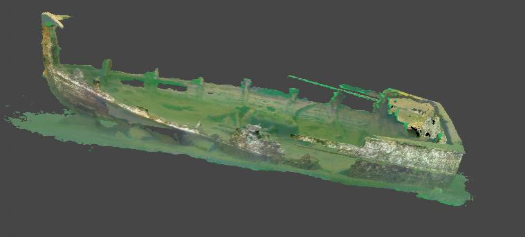

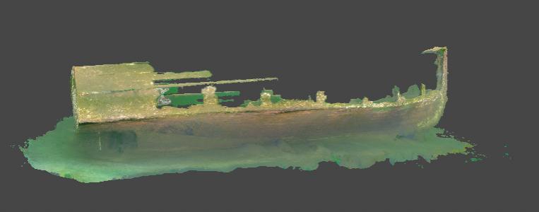

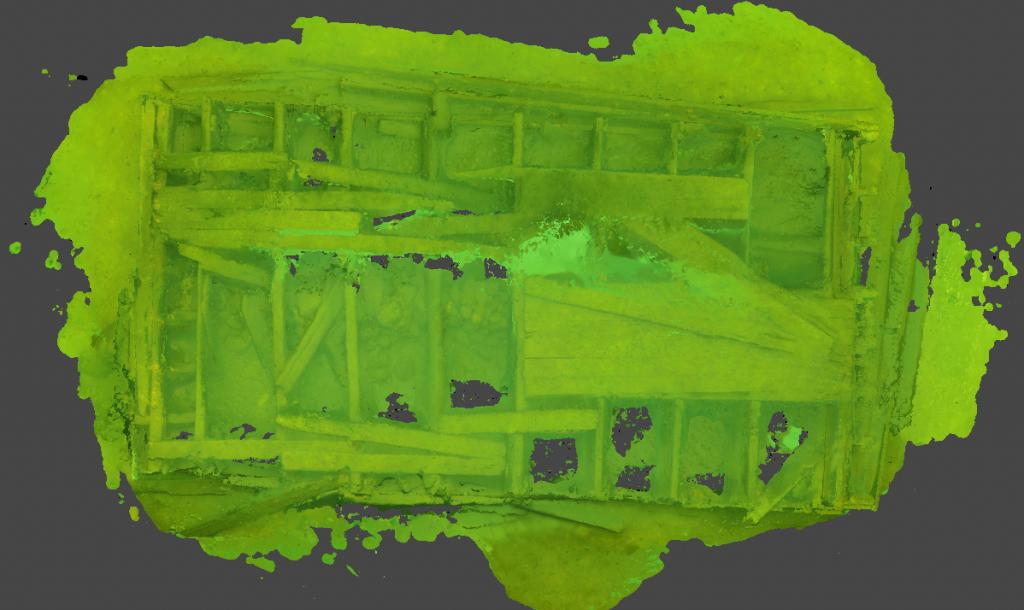

I am in the process of creating a number of new 3d models of shipwrecks in the lake. I have 3 that I have posted on my sketch fab already if anyone is interested.
https://skfb.ly/owSJ8

I remember that wreck-alot of fire damage and that unique bow. Very nice work.
Think about adding a red filter that should remove alot of the lime green tint. I am asked now and then why the water is that color-it's not, it's due to losing red from the spectrum as you descend through the water column.
