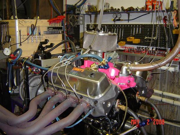

My engines are 4 years old and were originally design for 89 octane. They developed 647 HP on a dyno with MTBE added 89 octane fuel. After doing a rebuild on one this past winter , it was redynoed and retuned (timing and carb jetting) and wound up with 661 HP on ethanol added 87 octane. The other engine was retuned to the same specs.
It can be done but it's a risk for an amature
Disclaimer..."Don't try this at home"

The engine shops can use tricks to "fool" a motor, fattening up the mixture (so you burn more gas, but can use a lower octane) retarding the timing etc... the end result is that it is doable, but at the cost of engine efficiency. You end up burning more gas than its usually worth. Cal's motors are specially built HiPo motors that were tuned by an engine shop on a dyno. If you have a stock Merc or Volvo motor, leave it alone if you want it to live...

Hey Cal,
I'd love to hear more about the parts in your engines. Compression ratio, bore and stroke, connecting rods, cam specs, valves, heads etc. Those are impressive numbers for 5400 RPM, normally aspirated, and a marine cam to prevent water reversion.
