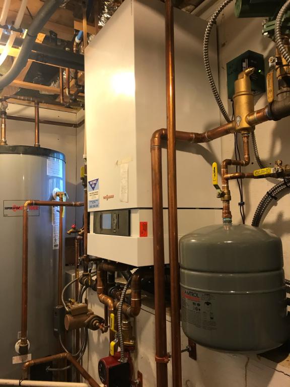

...ended up going with the Viessmann Vitodens 200 Boiler. When it took a full 4 days to install, with a lot of new piping and wiring, I felt better about the high price...Ha! I ultimately chose to go with this unit as the heat exchanger and other internals are stainless steel, (as opposed to aluminum), so theoretically it should be less susceptible to corrosion and leaking. And it is amazingly quiet...you cannot hear this thing go on!

The previous owner, who built the house, was/is an HVAC/Plumbing contractor. It was built with the geothermal as the primary heat source, but with propane system as a back-up and/or supplemental system. In the winter, we set the thermostat for the back-up heat system pretty low...in the 50's. This saved our bacon several years ago when the geothermal pump failed while we weren't at the house for a few weeks.

I had a lot of trouble after installing a Buderus a few years ago, and replaced it with a Viessmann last year. It was installed by Rowell and was actually cheaper than the Buderus. It has a titanium boiler with a much better warranty. Very happy with it.
