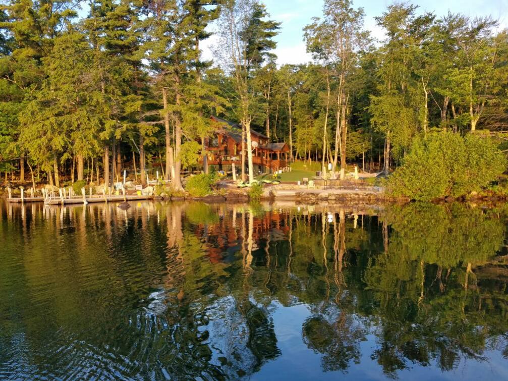

Sluggo, your beach looks very similar to what we want. Any chance you can send another pic from the angle looking back at it, say from the end of the dock? Beautiful!
This pic might be helpful if you zoom in on the beach!Name:  20170717_055140.jpg
