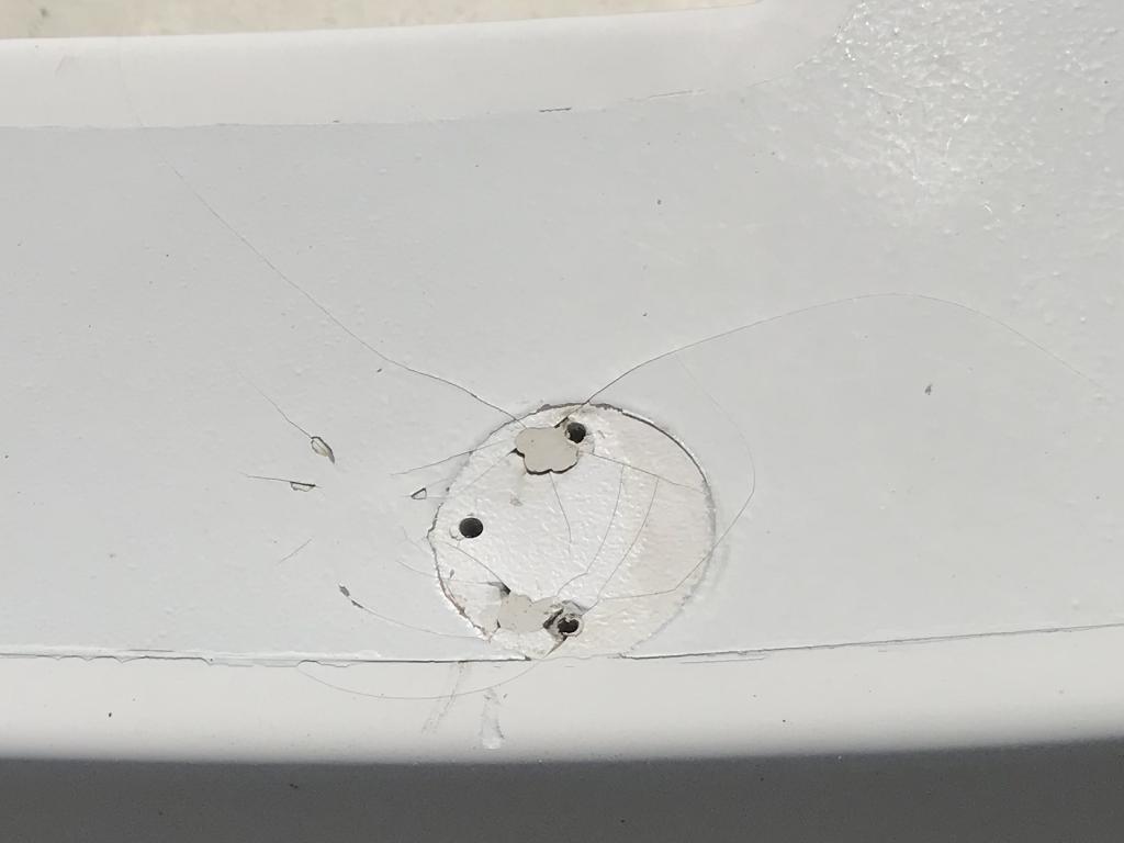

This 1995 beauty had a small tree fall across the bow rails years ago. The previous owner got a new rail, but it was not exactly the same. He preferred the taller one, so he could get into the boat through the rail at the ramp. (Rubberized keel!). We installed the new rail and the tree damage needs repair and then covering up. We decided on Total Tread.
