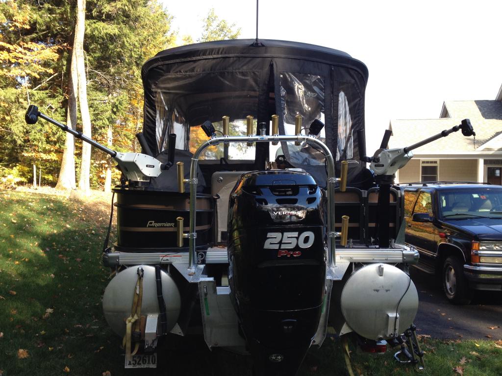

You will love fishing from a pontoon boat!! Once you do it you will never go back! It is by far the most comfortable way to troll for hours.
Below is a few pics of the Premier I purchased last year from Winnisquam Marine. It's a custom floor plan that Winnisquam has made just for them. As you can see, the entire stern is dedicated for fishing.
I utilized the ski tow bar for my rod holders which worked out great. I also mounted two LED marine lights for those early morning and late evening charters.
I have my planer mast mounted in the front just outside the playpen gate in Berts track system for quick and easy install and removal(sorry no pics). You can walk right up to the mast and reel the boards in which is very convenient.

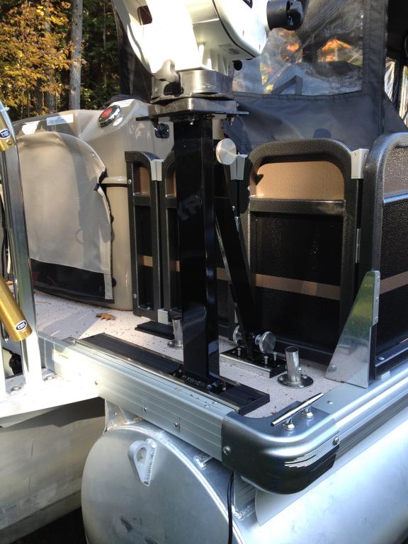

The downrigger mounts I custom made and had them powder coated. They mount into a Berts track system for easy and quick removal also. The box you see between the two rear facing seats in the center rear is a live well.
Over the winter, Winnisquam Marine mounted a 9.9 Mercury trolling motor with a Panther T-5 remote steering unit and throttle control and they did fantastic job and were great to work with!! Don't have any pics of that yet, but I am looking forward to using it soon!!
I would recommend a similar open stern setup if your looking to purchase.

That's a seriously nice setup, ishoot!! Well done.

Ishoot....those rod holders on the side. Did you have to drill through the aluminum to mount those. I'm looking for a good quality rod holder and I would lke to avoid any drilling.

Good question! No I did not, what I did was I cut 1" x 1" square aluminum tube about 4" long, end capped them, then painted to match railing.
I then applied the 4" blocks to the underside of the railing using a special 3M VHB (Very High Bond) tape. I then placed the Scotty rod holder over the rail and block and installed two #12 stainless tek screws into the blocks only. If you look closely, you can see the block in the picture.
I was determined with this new boat not to have any additional screw holes whatsoever anywhere on the boat, especially the railing or side walls. So far so good!
In my opinion Scotty makes the best rod holders for this application, actually all their equipment is top notch!
