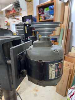

Have a 75 year old drill press belt drive that the motor just burned up. Does anyone know of a electrical motor repair shop they would recommend? Motor case has the bracket welded to it so thinking I will need to get it repaired

A new motor should be readily available for about $165.00 if repairing doesn't work out.
I agree. I wouldn't even bother to try and repair the motor.
It will cost more than a new motor.
I'm sure you can get a motor on Amazon or Grainger or something.
Might end up with a new control for it and possibly a different belt depending on the height it ends up at.
If you know how to run that drill press it takes about as much skill to replace it yourself

You probably want something like this. Check RPM and HP.
If your shaft is not standard, probably easier to get a new pulley too.
https://www.grainger.com/product/DAY...se-Motor-5K534

If you match the frame number all the dimensions including the shaft size will be correct. I'd guess it's either a 48 or 56 frame. Other frame sizes may fit too.

Make sure the motor you get a spins in the right direction. Some are hardwired to spin clockwise or counterclockwise, and some can be wired to reverse direction.

What KDL says:
Match the frame number, and you'll probably be good to go.
