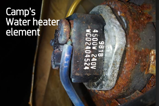

Element pictured below—by cellphone—before removal.

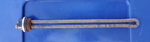

Below is a typical water heater element (removed), although some will have physical damage or appear "wilted":
