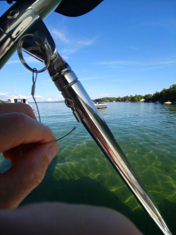

Hi folks. On my 2012 Cobalt 210, the bimini top frame is secured together with pins that have 3 inch long cable lanyards which are crimped to a fitting which is riveted to the frame posts. I think most smaller tops are like this. The problem I noticed this year is some of the cables are breaking at the crimped connection due to fatigue or maybe some corrosion. I've searched around but haven't found any products that seem more reliable. I can think of some homemade solutions but figured there would already be something out there.
Anyone have the same problem and come across anything?
Thanks
Bob F

Hi Dave. I have the same pins without the ball detent. It's the other end I don't like on mine because the cable is crimped into a fitting which in turn is rigidly riveted to the post. So when the pin and cable swing freely or get forced out of the way the cable end in the fitting gets stressed.
These from Amazon at least allow the cable end to swing freely eliminating the stress point.
A screw in place of the rivet, or another rivet, would be needed to mount the plate. Definitely better. Will consider.

Finally got a picture of the pin and broken lanyard.
Thanks Charlie but I think I might go with the assembly Dave refers to from Amazon or purchase a direct replacement and use a screw or pin that allows the crimped fitting to swing instead of fixing it rigid.
