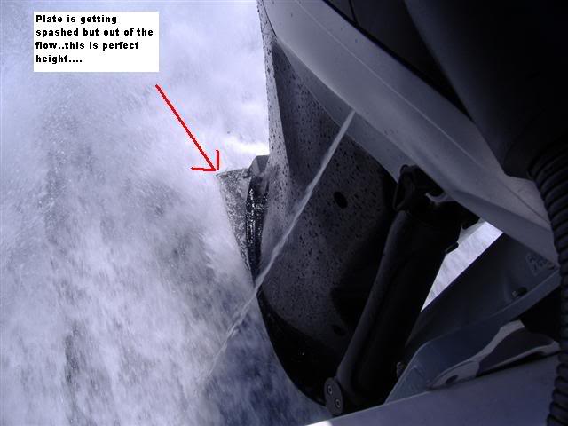

Going down a pitch will raise your RPM but will most likely slow your speed down a bit. Your engine is rated for 5800- 6400 RPM at WOT. Your rev limiter should kick in at 6400. With pontoon boats you want to prop to the higher end of your rating so when loaded the engine performs well. You would need a 19P for faster speeds but your RPMs would be too low and I would not recommend it. If anything you could go down a pitch to raise your RPM's slightly but you may lose a mile per hour or two. Your pretty good where you are at, if anything try a different style prop, I am not that familiar with Mercury props but am sure there are a lot to choose from.
Dan
Edited to add this: http://www.mercurymarine.com/engines...letin/?ID=729&

Depending on the power curve of the engine sometimes dropping a pitch will still maintain or even increase speed. We found this on the Boundary Waters. Engine mounting hole position on the transom makes a difference as well. The Verado runs 6400, yet we were running mid 5000's as it was set up so we still had a ways to go in the curve.

Codeman brings up a good point regarding engine mounting hole. Basically you should be able to clearly see the cavitation plate of your motor just above the waterline at WOT as shown below. If you can't you need to raise your motor.
