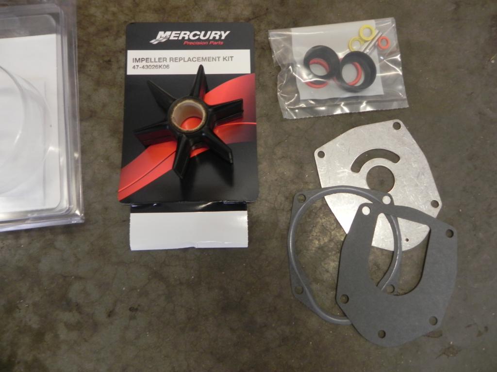

I just went out into the garage and it's kinda raw and cold out. Hmm think I'll wait for it to warm up a bit before ripping my stern drive apart. If I'm not to messy I'll snap some pix of the job and post 'em.
Old 03-17-2012, 03:56 PM   #18
MAXUM
MAXUM's Avatar
Location: Kuna ID
Posts: 2,755
Thanks: 246
So here's where we start.
Old 03-17-2012, 03:59 PM   #19
MAXUM
MAXUM's Avatar
Location: Kuna ID
Posts: 2,755
Thanks: 246

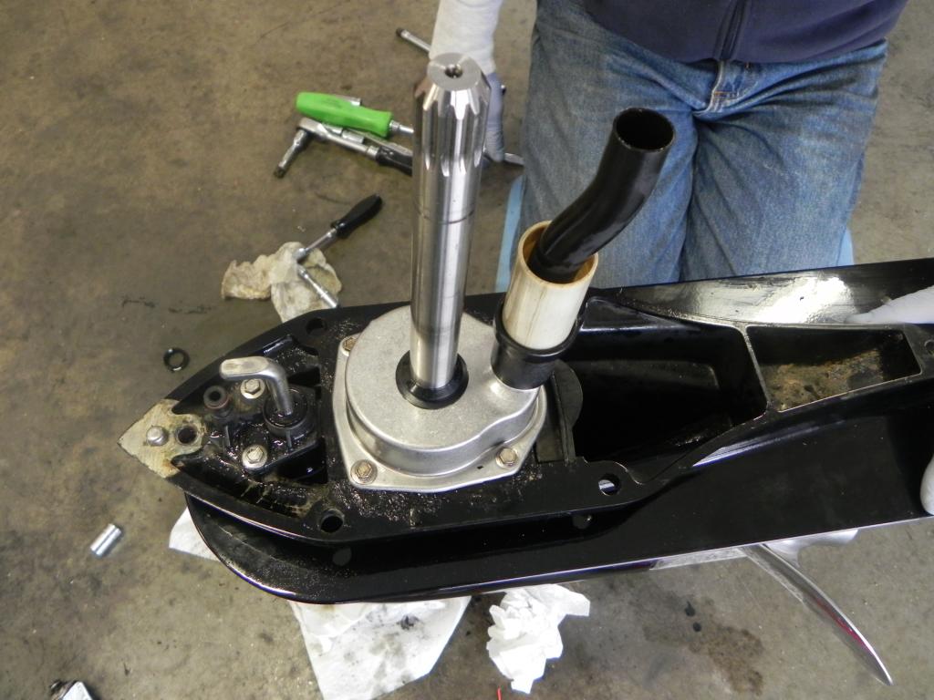

And we move on to splitting the lower unit....
Old 03-17-2012, 04:04 PM   #20
MAXUM
MAXUM's Avatar
Location: Kuna ID
Posts: 2,755
Thanks: 246

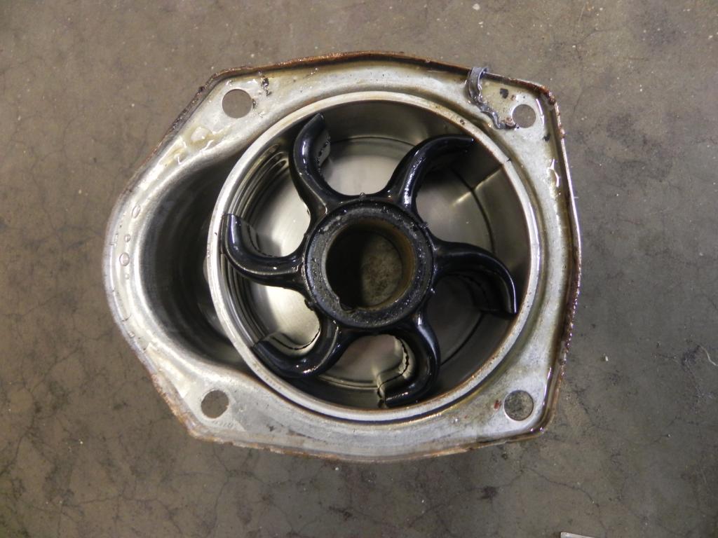

Disassemble the impeller housing. Kind of messy in there. Most of that is just crap that built up over time from being in the water. Keep in mind this boat does not sit in the lake for the season!
Old 03-17-2012, 04:09 PM   #21
MAXUM
MAXUM's Avatar
Location: Kuna ID
Posts: 2,755
Thanks: 246
Clean everything up, clean the pump housing, insert new impeller bolt housing back together, replace o rings as needed, almost ready to go.....
Old 03-17-2012, 04:14 PM   #22
MAXUM
MAXUM's Avatar
Location: Kuna ID
Posts: 2,755
Thanks: 246
insert inlet tube and it's ready to go back together. All in all took a little less than 2 hours to do and about 50 something in parts including the gear oil. Best part was firing the engine up after it was all done. Nothing says spring like the first time that boat engine runs!
Thanks for the pictures MAX. I think I've learned something here. It looks like the impeller is central in the SS housing...no offset. I always thought there was a wedge in the housing that would make each impeller blade flex/compress as it went over the "eccentric" wedge.
Maybe I'm thinking the bronze Jabsco belt driven pumps that I had on my old Yanmar diesel sailboat auxiliary. NB
NB - if you look very close at the pic I took of the old impeller still sitting in the housing you will see that it is in fact not centered but slightly off center. Notice the fins towards the bottom are slightly more bent than the ones on top?
It's not huge but it's definitely not centered. I assume there is a reason for it although I can't tell you why it would be done like that.
An interesting thing to note. This is the first time this has been done, so all these parts were 9 years old. The impeller looked like new but and interesting thing that I noticed was the seal on top of the housing was showing some significant 'dry cracking' and I suspect that it wasn't to far away from leaking. I also noticed the replacement seal had a much wider 'skirt' on the bottom. where it squashes against the pump housing.
Kinda cool to see one of these things disassembled partially for those that never have.
