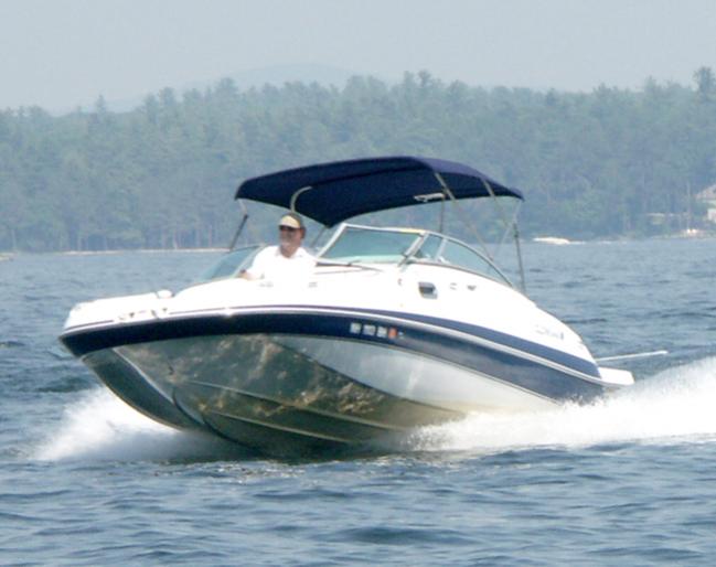

We have a four winns 214 deck boat. (Funship)
Pros:
When the kids were little they loved to ride up front.
Now the kids love to ride up front with the girl friends (same side)
If you get a door it is a great way to control the temperature in the back.
Easy for people to step off the dock and into the boat in front.
Holds a lot of crap when we load up. (Like the back of a pickup for us)
95% of the time the broader hull is not a problem with the rough water.
Cons:
5% of the time it can make the rough days hard hitting.
Some of the time when rough, I find it really tough to leave people up front due to splash and hard ride.
Sometimes the kids did not find it cool enough. (I encouraged them to buy whatever they would like and I would be happy to ride in their boat)
I don't like doing the proper 45 degrees into the wind because the splash and lift from the front corners can be a bummer.
Did I mention that it is hard hitting going into the wind on rough days?
Bottom line: We are on the Broads and I will always own a deck boat. The pure hauling capacity for people and stuff is a big plus for us. If I had to go 5 miles up the broads on rough days I might have a different opinion. I would not buy one without a door and full window as the ability to control the wind and spray is critical to my marriage.

The above boat is actually considered a 24' boat, but actually it is a 21' boat with a 3' swim platform. The swim platform size is great for lots of reasons.
When it is a rough trip, I always sit on the back seat - it is not so hard hitting there.
The kids love the bow fill in for fireworks and sunbathing.
Having a boat with a such a roomy head is great.
Our oldest son has the most issue with it not being a very cool boat. As you can see, he solves that by putting down the bimini.
Our Four Winns has been pretty good in the wind and weather because of the door and glass. We also purchased the full vinyl, which is very much appreciated in October.
This boat is nice because it can handle a lot of people.
Good luck soxfan!
