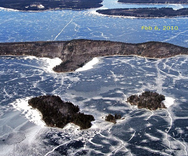

These snow-free conditions last year probably contributed to the early Ice-Out:
